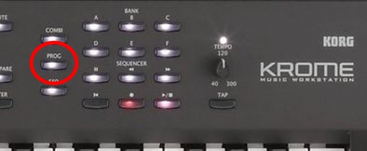

So that's what that button does?! I thought it made you sound like Tony Banks or Joe Zowinul.
Common mistake, on a Korg keyboard you actually use the "Prog" button for that.
