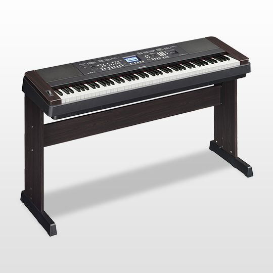

A few days ago I purchased a Yamaha DGX 650 keyboard and I would like to know if there any way to play a ritardando when you have voiced in a 140 mm and style setting of 166? I am a newbie at this keyboard.

Welcome.
Playing a ritardando involves a gradual decrease in the tempo of the piece of music you play.
Yes it can be achieved if you are accompanying yourself or playing along with a backing track that includes it.
Style playback involves playing along at the tempo you set and the tempo stays the same until you stop playing, it is just a feature of the set auto accompaniment that is a function of these DP’s and of Arrangers. So no, you cannot play ritardando under these conditions since the Style playback tempo is fixed.
I believe it may be possible via MIDI control of the tempo via a pedal but I am unsure if your DGX is capable of this level of control. Or tap tempo controllers are available but I am unsure if they would work with your DGX.
OK so that said it is worth having a play with your keyboard to see if by using the Tap Tempo button on the keyboard whilst playing you can achieve a slowdown of the style playback, can you try this and get back to us?

Check the manual for your model to see what it says. Most Yamaha arrangers let you play a style's Ending with ritardando by pressing the Ending button twice. In fact, I'm looking at the manual right now, and I see that the button which triggers the style's Ending is labeled the same as it is on my PSR-E models: "INTRO/ENDING/rit.," where "rit." means "ritardando."
4,108
1,734
By the way, since the DGX-650 is an older model, I'm guessing you probably bought it used, which might mean that you didn't get a paper copy of the manual. But whether you did or didn't, I highly recommend going to Yamaha's site and downloading the PDF versions of all available documents for your keyboard. It's a lot easier to find specific information in the manual by searching the PDF version for a given word or phrase.
