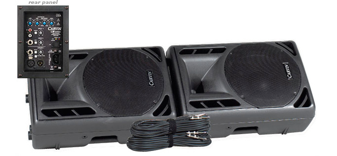

If you're inclined to go this general route, I'd ignore the Mackies and go with Carvin LM12As (there are also LM15As). Each speaker mounts on a stand (as do the QSCs) or can be used as a floor monitor. They only weigh 27 lbs each, have been drop tested at over 8' (don't do that with a K12) and have a 350W RMS (700W peak) amp built in, divided 50W to the treble horn and 300 to the 12". A *pair* of the things with a pair of 50' cables will run you $739. http://www.carvinguitars.com/lm/ Subs are available.

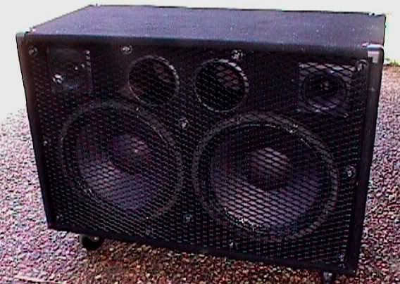

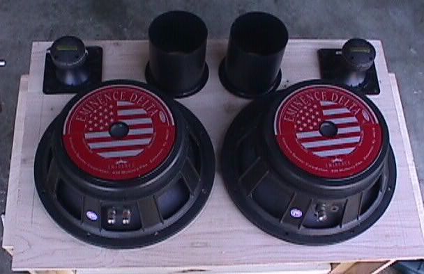

I've taken another tack. I built a pair of 2x12 stereo cabinets (yeah, each cabinet is stereo/mono capable) ported and sized for 400W (each) Eminence Delta ProA speakers, each cabinet with a pair of 400W (each) 1165 piezo tweeters. The porting will take these speakers down to about 52Hz, the tweeters up to 18Khz. I've powered the pair of them with a Carvin rackmount DCM 1540L solid state stereo power amp (740W/740W at 4 ohms or it can be bridged for mono operation). One on each side the drummer up on cases that bring the cabinet up to between 4' and 6'. The whole rig will fit in the back seat of a Honda Civic (4-door), with room for keyboards in the passenger seat and the girlfriend in the trunk.
I paid a guy who makes kitchen cabinets $125 each to build these in raw birch plywood, with finger joined corners and all. The Delta Pros are around $125 each, the tweeters about $40 each. Add in some money for casters (removable), handles and other hardware. The prototype was done with an outdoor rug covering (below), but mine were covered with spray-on pickup truck bed liner, which is so much tougher than tolex that it's nearly structural.
I've tested them with Studio Six Audiotools' iPad app, and I have 1/3 octave EQ in the rack. They're not flat, exactly, but they're not bad at all. Obviously everything's going to be different at gig time from what it was at sound check with an empty room, so you may want to compensate.
But this setup will blow the doors off any 100W Marshall stack with ease, and if you have the boxes up where folks in the band can hear them, you'll be amazed how quickly everyone decides that stage volume can be reduced by running things through a good PA.
