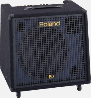

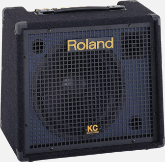

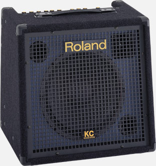

I was wondering if I choose a keyboard amp, lets say the KC-150 vs. KC-350 vs. KC-550
Is it that the KC-550 will sound better or just that it can be louder? Especially compared the 350 to the 550. And what is the feature of the speaker that determines if it will sound better? What mechanical attribute? Is it the wattage or...? I really have no idea so thanks for any insight you can provide. I put the specs of these amps below:

The 350 is a monstrous 54 lbs in weight so I do hope you are not intending to use it for gigging. For home use it is way overkill.
