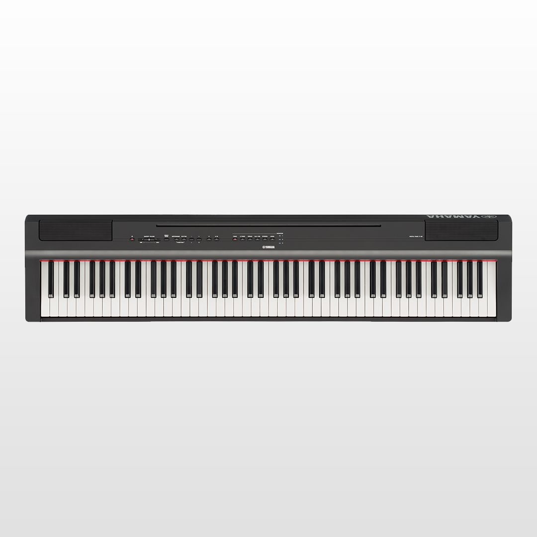

I'm buying a Yamaha P-125 digital piano. But got no clue about how to record stuff I play in best quality in my computer.
I previously had a PSR E443 and never got able to record stuff in the computer. I used a USB printer cable and installed the Yamaha Steinberg
USB Driver to the computer. But when I connected the keyboard to the computer, the device never got recognized.
So with my new keyboard, I really need to figure out how to do this successfully. I'll really appreciate some steps to get this done.

I bought the new P125-B and was able to succeed in this.
Just needed
  • USB printer cable ,
  • Install the 'Yamaha Steinberg USB Driver' to the computer.
  • 'Audacity' as the software to record audio
Thanks everyone.
On a side note, P125-B is a great digital piano. With the sustain pedal, it sounds fabulous.
