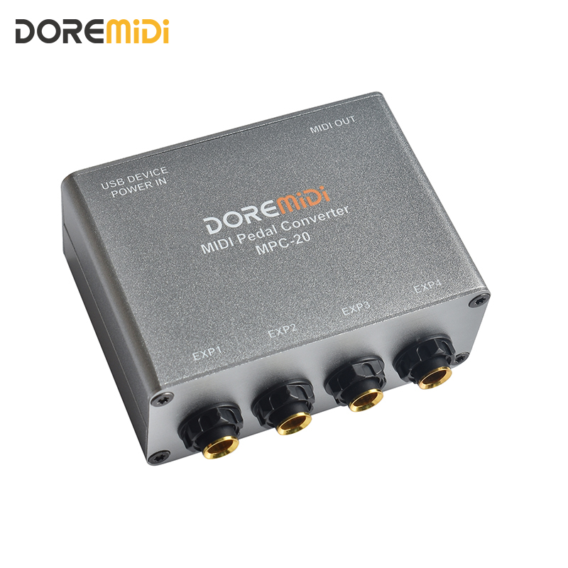

Is there such a thing as a unit that handles sustain/sostenuto/expression pedals with 1/4 inch input jacks for standard pedals? I could use something like this. I am back lining keys on fly dates, using MainStage, and I’d like to not have to deal with setting up unfamiliar keyboards before soundcheck. Bypassing keyboard architecture seems like a good idea.
5 pin Midi output preferred.
Using a MioXM and Radial KL-8.

Thanks for the reply happyrat1. I’m a Kurzweil user too. What I am looking to do is bypass the keyboard. Have the pedals NOT into the keyboard but into a separate unit that can then send midi out via 5 pin midi, or usb if 5 pin midi out isn’t an option.

happyrat1 I really appreciate your replies. I am not looking for pedals. I am looking for a unit to plug pedals into that can then send midi out from the pedals. Looked at the Raspberry stuff. Didn’t know what I was looking at or how it would help me.
PS- Sostenuto and una corda (soft) are indeed midi CC parameters. Midi 66 and 67 respectively iirc.

If I understand you correctly, you want to plug a few "sustain pedals" into a box and have that box transmit MIDI cc messages to your kb. As HappyRat says, there are many MIDI foot controllers but I don't know of any that don't come with their own footswitches. Keymaninaz probably has the best suggestion, I will look into something like that myself.
I use a Boss GT1000 to send MIDI cc messages, such as modulation, sustain, etc. I also use it with a stereo in for audio processing. And a volume pedal. And a solo boost. Plus you can plug 2 latched/unlatched pedals into it for more control. The trade-off is using regular, old, stomp-box style footswitches for sustain. But I'm Ok with it for all the rest of the functionality. I don't need a Key Largo or anything...

I have found something like what I’m looking for, although I’m told it has poor reviews.
