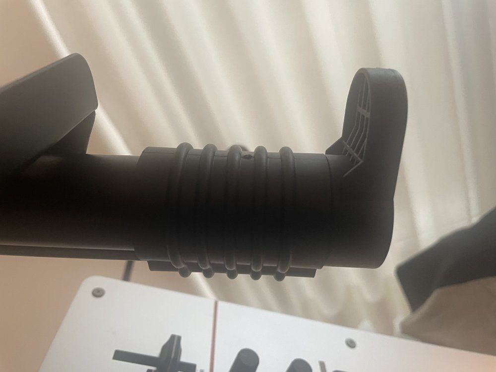

I recently bought a Quik Lok QL/723 three-tier keyboard stand and I’m trying to improve one small aspect of the setup.

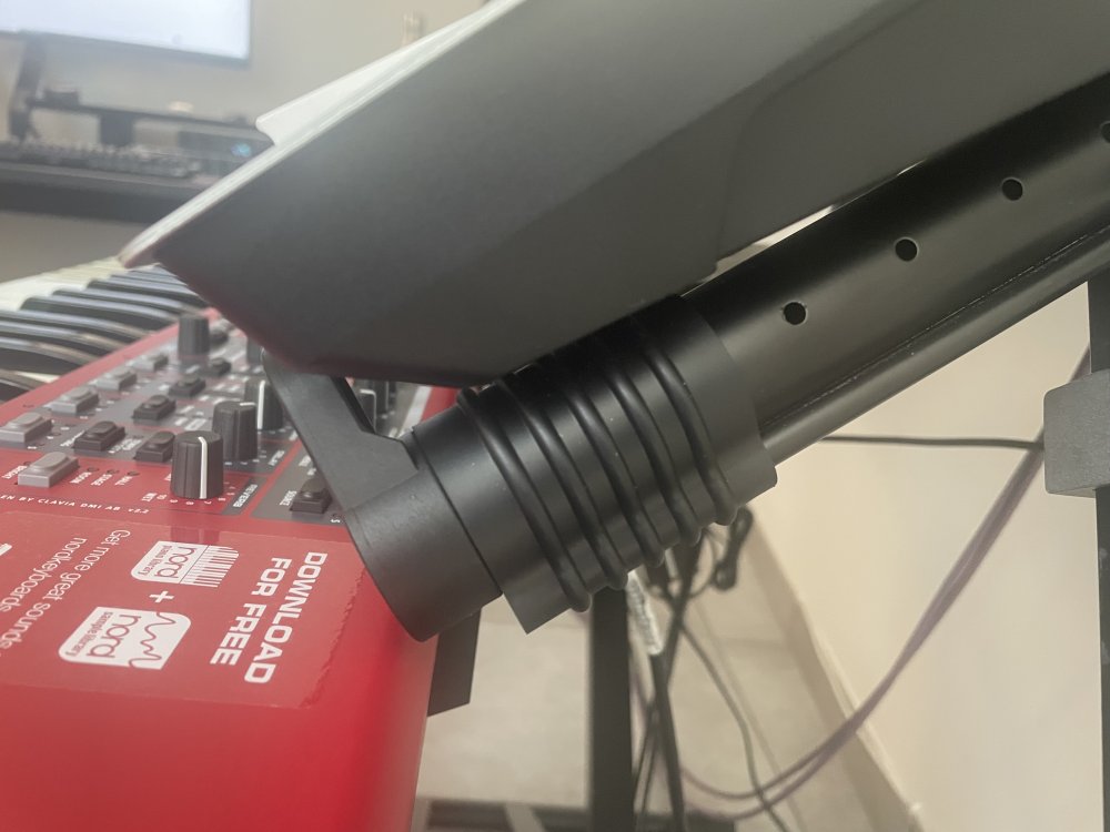

I have a Roland Gaia 2 on the middle tier, which I keep tilted at roughly 40°. This angle is actually perfect for playing while seated and gives me very comfortable access to the controls and, more importantly, it is the only practical position I found that is compatible with the geometry of the third tier.
The problem is that the small L-shaped plastic stops at the ends of the support arms are quite short and, since the Gaia has a somewhat rounded bottom/front edge, I’m worried that enough movement could cause it to slide over the stops.

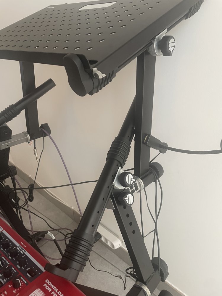

I’ve attached a few photos: first is the actual stop, second one shows how the rounded front/bottom profile of the Gaia does not sit very securely against the original L-shaped stop, and third one shows why I cannot simply reduce the tilt angle: the horizontal arm of the middle tier would interfere with the vertical support of the third tier.

Being the DIY type, I’d extend the vertical part of the L by slipping a short piece of rubber hose over it, and securing it in place with wire or a zip tie under the post. Just need to drill a hole in either side of the hose at the bottom. I’ve found rubber against plastic prevents slipping, too. Pretty primitive, but most of my rigs are. Good luck!
