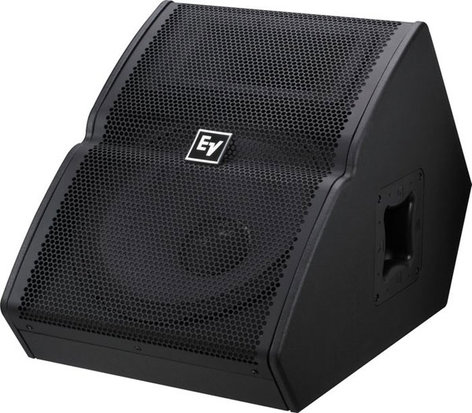

So now im going back on what i said and looking at a K8.2. I did want a DXR8 MKII, but it’s not angled so not ideal for floor use, where it will need to be.
So, any more thoughts on a single 1x8 as a floor monitor for keys? We arent a loud band as such, both guitarists use small combos. I just cant get my head around a 1x8 sounding full and clean loud.

Its the floor aspect im not sure about. I have no issues believing these speakers works really well when stand mounted, but with a 8-10ft distance im not so sure the sound will be clear and punchy.
You can look at the horizontal/vertical dispersion characteristics to get an idea as to whether you will get a clean throw from the speaker's position to your ears. Some speakers have the same dispersion horizontally and vertically, most don't. The ZXa1-90 has a rotating horn so you can get the preferred horizontal/vertical dispersion regardless of whether the speaker itself is placed horizontally or vertically. But ideally, while you want to be within its dispersion radius, you also want to minimize floor reflections. Which is why using many speakers designed primarily for "mains" use instead as a floor monitor may be usable but not always ideal. Something designed for floor use is likely to be able to be angled such that the horn won't radiate much to the floor, as shown in these examples...
Whether those designs work well at 10-12 feet away is another question, though. They may shoot "over your head." Monitors are usually not that far away, your setup sounds unusual.
It's not like speakers less angled (therefore generating more floor reflection) are unusable, you just probably won't be hearing them at their best. (Some speakers even have an EQ option to try to compensate for the "boundary effect" of floor use.) Same with a speaker that you can't quite get optimally on-axis to your listening position, but only "close."
You can also consider putting your monitor on a short pole, perhaps slightly off to your side. There are lightweight, compact short poles available which are not much of a hassle to use.
Also notable in context of this discussion is that these are all issues that have nothing to do with speaker size. The exact same things come into play whether your speaker is 8", 10" or 12".
